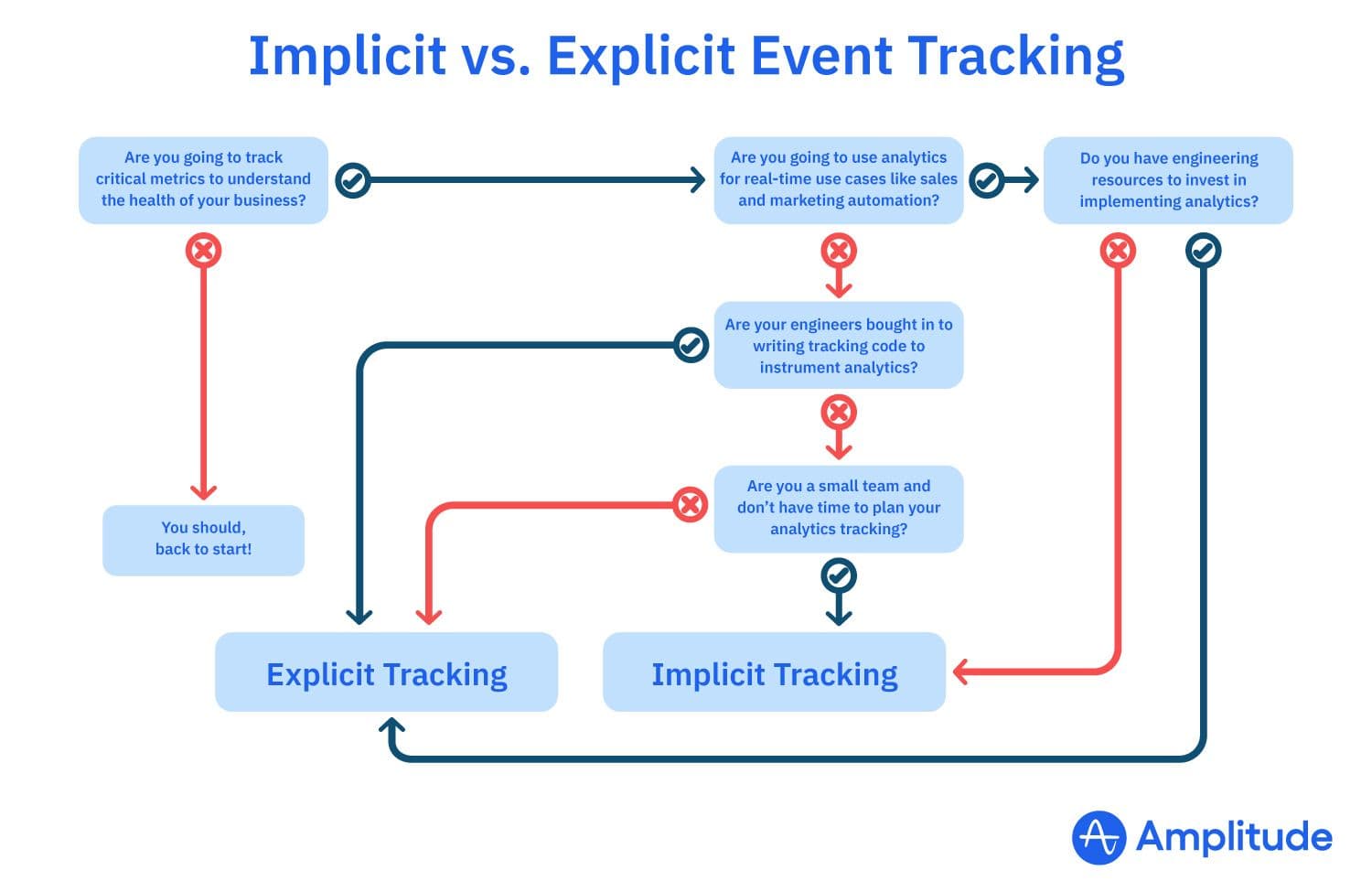

So what should you choose?
So when should you choose to use implicit versus explicit tracking? We’ve created a quick guide below to help as well as listed some of our favorite analytics tools in each category.
Ultimately, use the tool that works best for your team but understand the pros and cons of each approach. Many teams’ needs evolve as they grow and add additional use cases for event tracking data.
