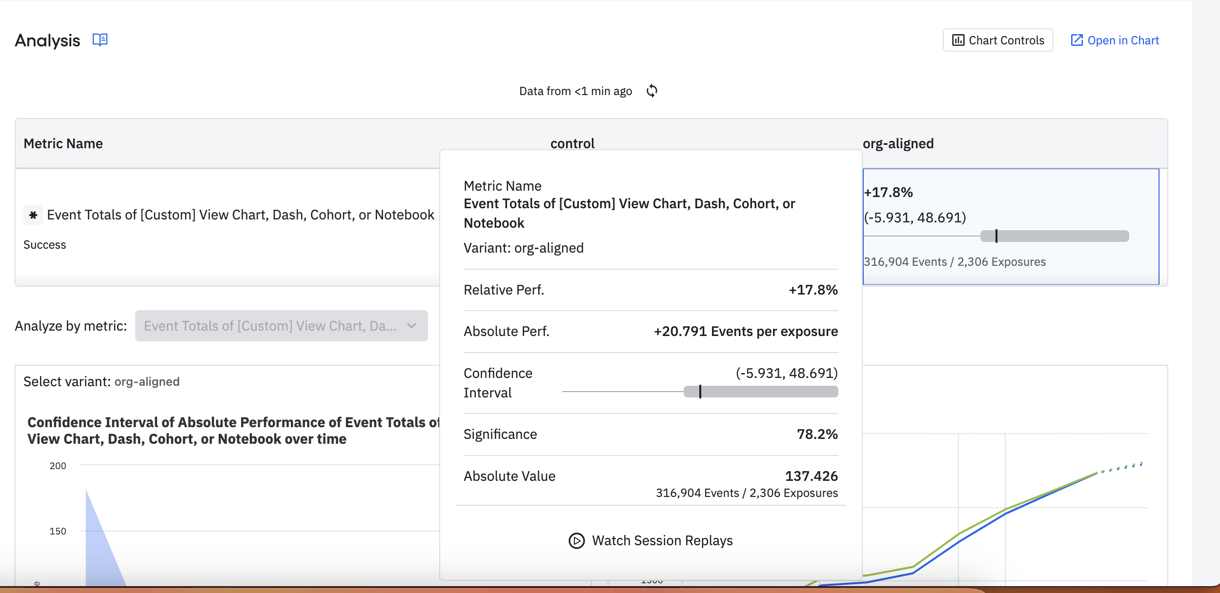

The Experiment Analysis view
The Experiment Analysis view shows the details of your experiment. Select your experiment and then go to Activity > Analysis to view high-level statistical measurements. These measurements help you determine whether your experiment succeeded.

To turn your experiment analysis into a chart, select Open in Chart. Amplitude converts the experiment information into the most likely charts and opens them in a new tab. You can then modify the charts.

Relative performance
Relative performance measures the relative difference between variant performance and control performance. This is also known as the relative lift. To cross-check this value, expand a single metric's section and divide the absolute lift for a variant by the absolute value of the control for that metric.
Confidence interval
The confidence interval is a range of values that includes the parameter you're trying to measure. In this case, the parameter is the difference in the means between the variant and the control. The confidence interval isn't a probability. Interpret the confidence interval as follows: if you ran this experiment 100 times with the confidence level set to 95, you can expect the true parameter value to fall within this range at least 95 times.

If you have multiple variants, select the one you want to view in the confidence interval chart from the drop-down above the chart.
To access the confidence interval, hover over the control or the experiment metric.
Significance
Significance is the likelihood that the performance shown for each test variant differs from zero rather than reflecting random fluctuations in the data. The higher this value, the more confident you can be in your results. More formally, significance is 1 - p-value.
Absolute value
The specific meaning of the absolute value depends on the metric type. For unique conversions, Experiment expresses values as a percentage that indicates the percentage of users (over the total number of exposed users) who converted for each variant. The numerator Conversions and denominator Exposures appear below the percentage.
Otherwise, the value indicates the aggregate (total events, sum of property value, average of property value) for each exposed user. The denominator is the total number of exposures. For example, 10 total events / 4 exposures = on average, an exposed user had 2.5 conversion events.
To access the absolute value, hover over the control or metric name.
