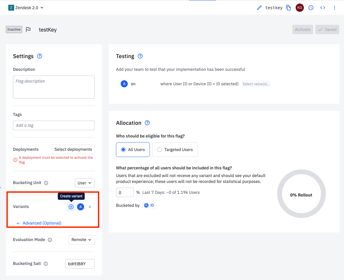

- In the Settings section, click the Add icon in the Variants section to add a variant. Flags must have at least one variant. A variant is the new feature or product experience you roll out to users. You can add as many variants as you need to a feature flag.
- Enter a name, value, and description for your variant. Amplitude Experiment generates the variant value from the name. The variant value is a string you use as a flag in your codebase. Click Apply.
