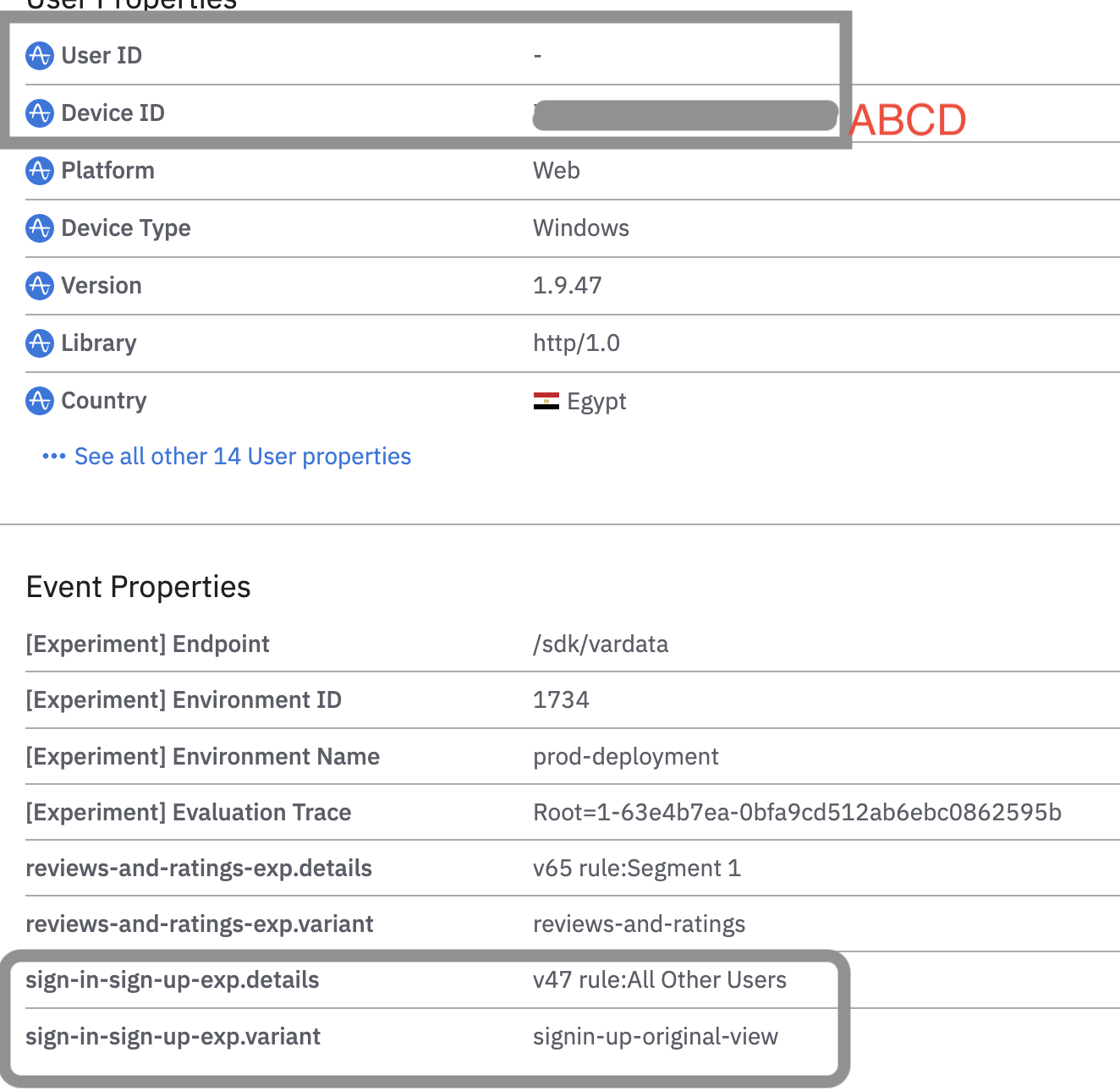

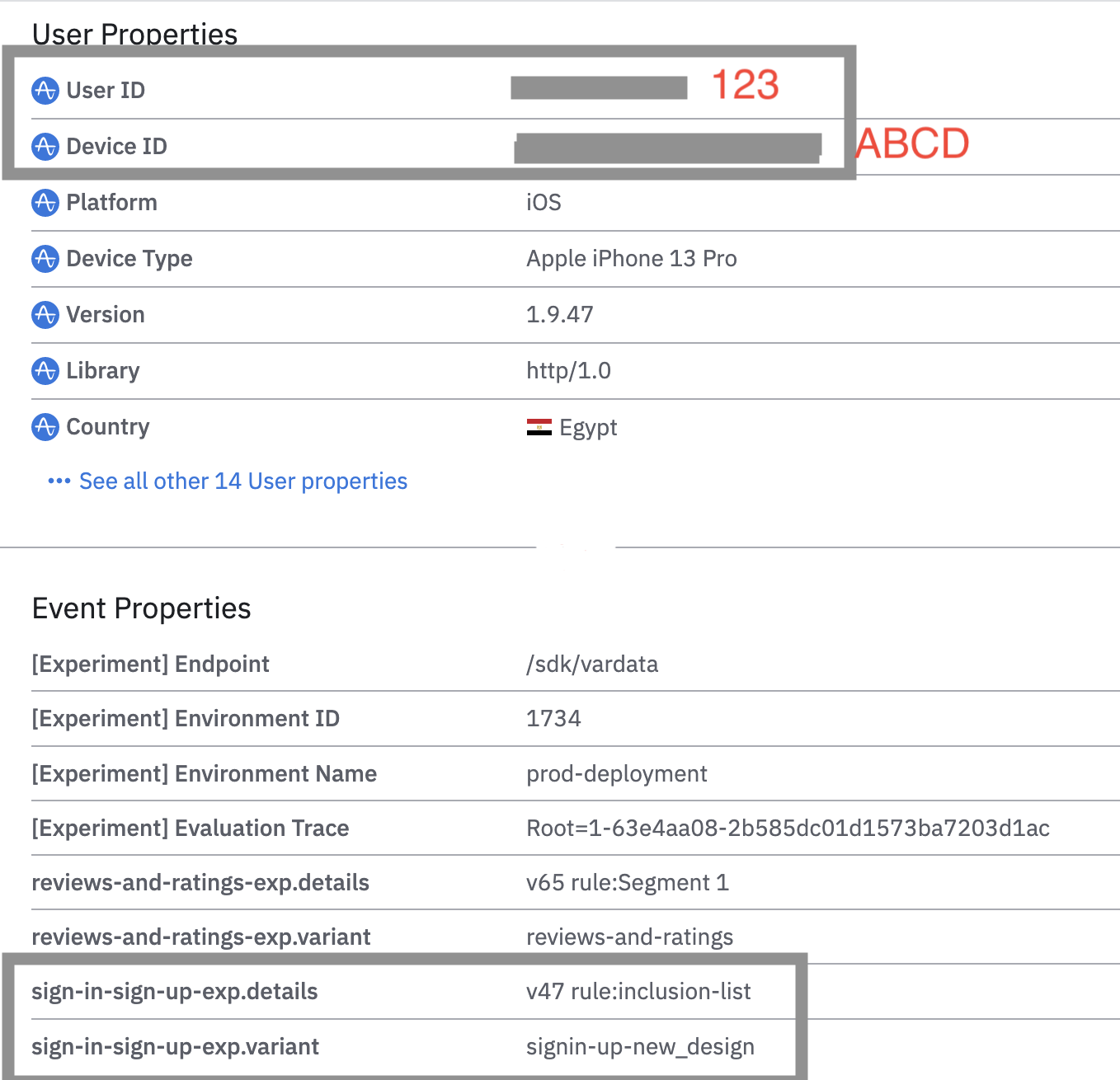

Imagine you have some user IDs in the inclusion list. You call fetch() and pass the user ID into the call. The call returns the control experience, per the inclusion list. The next time you call fetch(), you don't pass in the user ID. The user no longer meets the inclusion list criteria, so Amplitude hashes the bucketing key, and the user can receive a different variant instead. The same outcome can happen if you include device IDs.
In the following example, the user has a user ID. The user matches the inclusion list and receives the signin-up-new_design experience.
A user who has a user ID matches the inclusion list and receives the `signin-up-new_design` experience.
In this example, no user ID exists. The user doesn't match the inclusion list, falls into the "all other users" segment, and receives the signin-up-original-view experience instead.
A user with no user ID doesn't match the inclusion list, falls into the "all other users" segment, and receives the `signin-up-original-view` experience.
