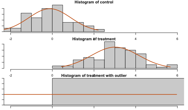

In this example, including an outlier in the dataset removes the statistical significance you'd get without it:
set.seed(29)
control = rnorm(100)
treatment = rnorm(100, 3)
t.test(control, treatment)
treatment_with_outlier = c(rnorm(100, 3), -1000)
t.test(control, treatment_with_outlier)
Without the outlier, the p-value is basically 0. With the outlier, the p-value is .495.
| Mean | Standard deviation | |
| With outlier | -6.92 | 99.81 |
| Without outlier | 3.01 | 1.14 |
This is the distribution of the population, not the distribution of the sample mean.

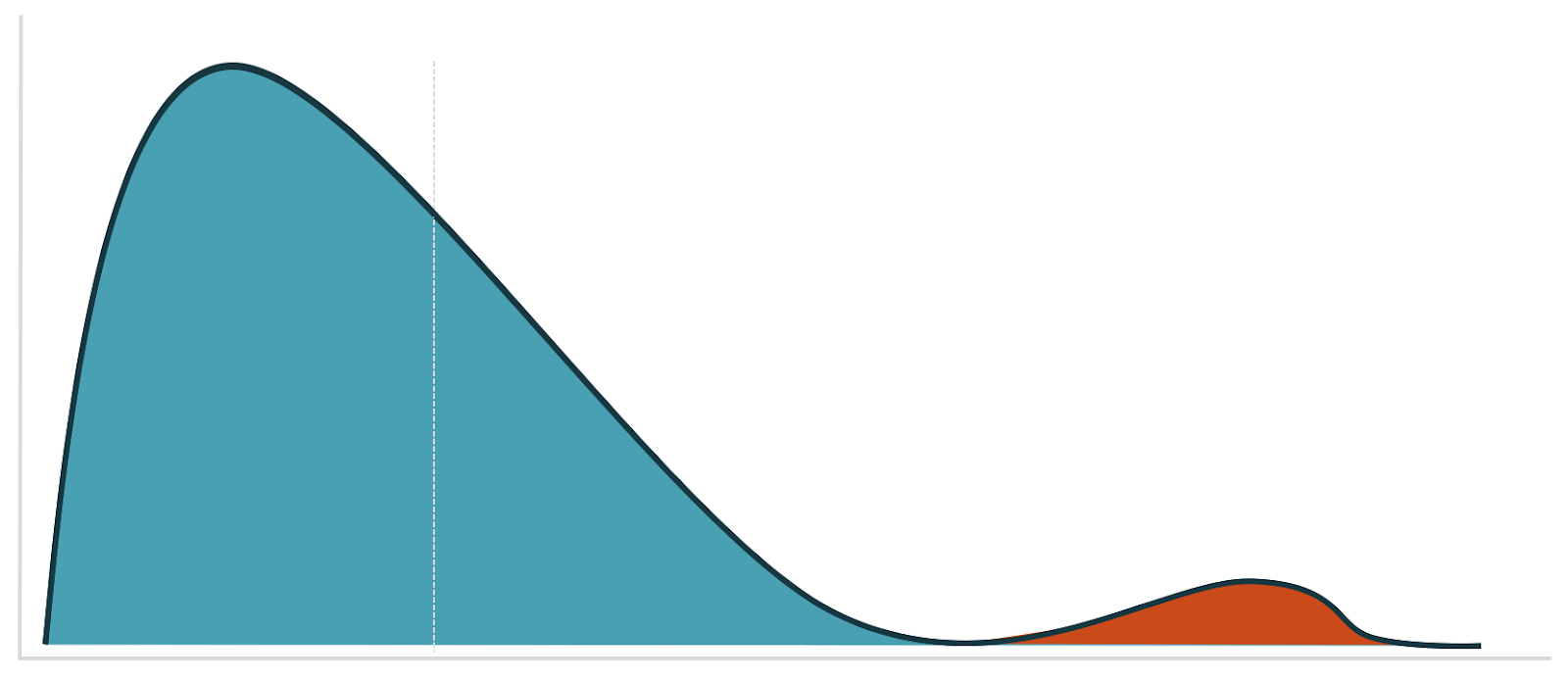

You have several options for picking your winsorization value. A good starting point is to refer to your visualization and look for a cutoff point that separates the data into two distinct modes:
