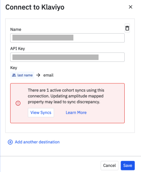

Warning when updating cohort mapping
Amplitude issues a warning if you attempt to modify the Amplitude user property mapping, because doing so can impact active cohort syncs. Click View Syncs to view the sync that could be affected. From there, decide if you want to turn off the sync.
Warning when editing cohort property mapping that may affect syncs
Even if you don't receive a warning, be careful when modifying the mapping properties. If you're not, you may get unexpected changes in the number of users tracked.
For instance, if you opt to stop mapping by email addresses and switch to phone numbers instead, users who were previously synced with their emails will not receive updates. Your modification will only affect new users. They'll be synced based on their phone numbers, while previously existing users will still be synced based on their email addresses. Over time, this could lead to data discrepancies.
If your cohort sync process has been in place for some time and you're considering changing the mapping, consider establishing a new sync destination first, and then proceed with the sync using this new target.

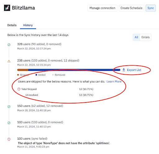

View sync history
The cohort sync history page provides a detailed breakdown of cohort syncs over the last 14 days. Each cohort sync provides a list of skipped, added, or removed users. To access this page, follow these steps:
  1. Click the Cohorts tab.
  2. Choose the specific cohort of interest.
  3. Click the Syncs tab.
  4. If multiple destinations are involved, select the appropriate cohort destination.
  5. Click the History tab.
  6. Click Export to export a CSV. See the Inspect CSV exports section below for more detailed information.
Cohort sync history with per-sync user adds removals and Export
Note
This detailed cohort sync history page is available for all cohort sync destinations except for Amazon S3 and TradeDesk. These destinations continuously perform a full sync of users, not just the initial sync followed by incremental changes, making CSV exports impractical.
