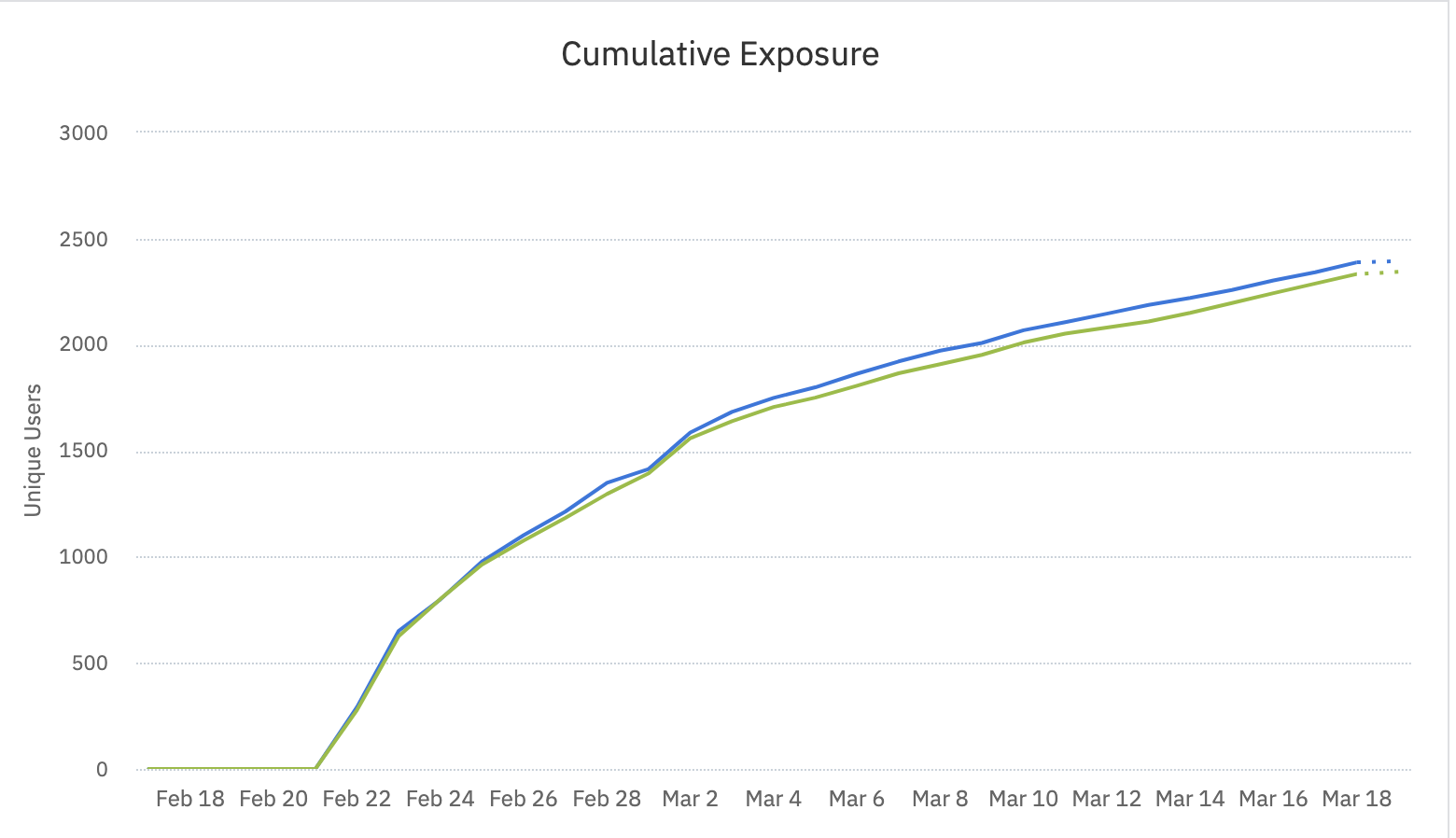

Increasing slope
In a standard cumulative exposure graph with an increasing slope, each line represents a single variant. For example, March 20 might be the first day of the experiment, when 158 users trigger the exposure event for the control variant. A day later, a total of 314 users receive the control variant. That number is the sum of exposures on March 20 and March 21.
The slope of each line is the change in the y-axis divided by the change in the x-axis:
∆y / ∆x = (cumulative users exposed as of day T1 - cumulative users exposed as of day T0) / (number of days elapsed between T0 and T1) = Number of new users exposed to the experiment, per day, from day T0 to day T1.
Additional aspects of this graph:
- The graph is cumulative, so the y-axis doesn't decrease. The slope of the line is the number of new users exposed to your experiment each day. The line may slow or stop growing, but a cumulative exposures graph never peaks and then drops.
- A dotted line at the end marks dates with incomplete data. Refer to Amplitude's incomplete data guidance for more information.
- The two lines don't track each other exactly. Each line represents a unique variant, and exposures can differ slightly between variants, even when each variant receives the same amount of traffic.
- Both variants follow a steady growth path, which indicates no seasonality. If users were more likely to engage with your product (and therefore more likely to receive an experiment) on weekdays, the chart would show this pattern. On weekends, the y-axis value would increase more slowly.

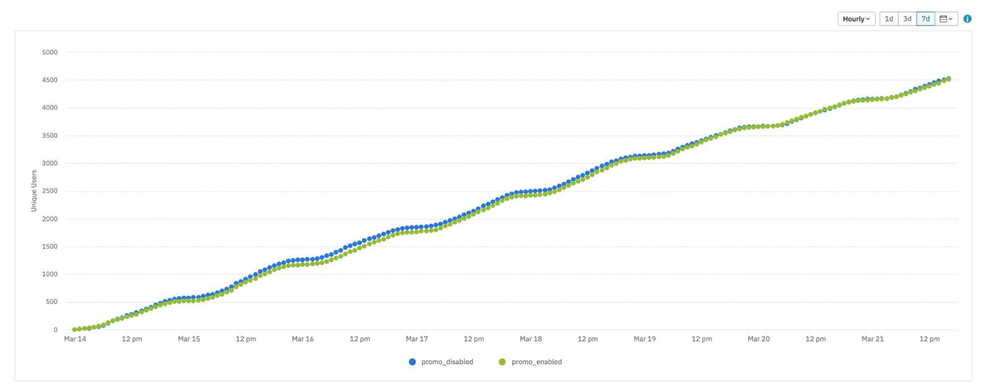

Hourly versus daily setting
Changing the x-axis to hourly instead of daily often reveals new patterns in your chart.
| Date and time | Control | Variant A |
| Mar 14, 2026, 12 AM | 0 | 0 |
| Mar 14, 2026, 1 AM | 9 | 5 |
| Mar 14, 2026, 2 AM | 16 | 16 |
| Mar 14, 2026, 3 AM | 22 | 23 |
| Mar 14, 2026, 4 AM | 32 | 31 |
| Mar 14, 2026, 5 AM | 40 | 39 |
| Mar 14, 2026, 6 AM | 69 | 73 |
| Mar 14, 2026, 7 AM | 118 | 115 |
| Mar 14, 2026, 8 AM | 184 | 151 |
| Mar 14, 2026, 9 AM | 225 | 193 |
| Mar 14, 2026, 10 AM | 289 | 253 |
| Mar 14, 2026, 11 AM | 344 | 301 |
| Mar 14, 2026, 12 PM | 410 | 348 |
| Mar 14, 2026, 1 PM | 457 | 414 |
| Mar 14, 2026, 2 PM | 514 | 464 |
| Mar 14, 2026, 3 PM | 540 | 520 |
| Mar 14, 2026, 4 PM | 601 | 564 |
| Mar 14, 2026, 5 PM | 635 | 619 |
| Mar 14, 2026, 6 PM | 675 | 640 |
| Mar 14, 2026, 7 PM | 726 | 693 |
| Mar 14, 2026, 8 PM | 776 | 709 |
| Mar 14, 2026, 9 PM | 826 | 746 |
| Mar 14, 2026, 10 PM | 833 | 753 |
| Mar 14, 2026, 11 PM | 840 | 762 |
| Mar 15, 2026, 12 AM | 847 | 766 |
| Mar 15, 2026, 1 AM | 856 | 773 |
| Mar 15, 2026, 2 AM | 863 | 778 |
| Mar 15, 2026, 3 AM | 870 | 786 |
| Mar 15, 2026, 4 AM | 877 | 791 |
| Mar 15, 2026, 5 AM | 884 | 796 |
| Mar 15, 2026, 6 AM | 923 | 823 |
| Mar 15, 2026, 7 AM | 957 | 876 |
| Mar 15, 2026, 8 AM | 992 | 913 |
| Mar 15, 2026, 9 AM | 1,040 | 966 |
| Mar 15, 2026, 10 AM | 1,085 | 1,028 |
| Mar 15, 2026, 11 AM | 1,137 | 1,077 |
| Mar 15, 2026, 12 PM | 1,195 | 1,122 |
| Mar 15, 2026, 1 PM | 1,262 | 1,179 |
| Mar 15, 2026, 2 PM | 1,336 | 1,235 |
| Mar 15, 2026, 3 PM | 1,391 | 1,289 |
| Mar 15, 2026, 4 PM | 1,448 | 1,338 |
| Mar 15, 2026, 5 PM | 1,502 | 1,363 |
| Mar 15, 2026, 6 PM | 1,530 | 1,398 |
| Mar 15, 2026, 7 PM | 1,587 | 1,426 |
| Mar 15, 2026, 8 PM | 1,642 | 1,470 |
| Mar 15, 2026, 9 PM | 1,676 | 1,510 |
| Mar 15, 2026, 10 PM | 1,684 | 1,515 |
| Mar 15, 2026, 11 PM | 1,693 | 1,521 |
| Mar 16, 2026, 12 AM | 1,702 | 1,531 |
| Mar 16, 2026, 1 AM | 1,711 | 1,541 |
| Mar 16, 2026, 2 AM | 1,720 | 1,546 |
| Mar 16, 2026, 3 AM | 1,730 | 1,553 |
| Mar 16, 2026, 4 AM | 1,737 | 1,561 |
| Mar 16, 2026, 5 AM | 1,748 | 1,567 |
| Mar 16, 2026, 6 AM | 1,784 | 1,608 |
| Mar 16, 2026, 7 AM | 1,821 | 1,634 |
| Mar 16, 2026, 8 AM | 1,868 | 1,691 |
| Mar 16, 2026, 9 AM | 1,931 | 1,748 |
| Mar 16, 2026, 10 AM | 1,995 | 1,810 |
| Mar 16, 2026, 11 AM | 2,068 | 1,856 |
| Mar 16, 2026, 12 PM | 2,129 | 1,917 |
| Mar 16, 2026, 1 PM | 2,203 | 1,965 |
| Mar 16, 2026, 2 PM | 2,262 | 2,004 |
| Mar 16, 2026, 3 PM | 2,319 | 2,058 |
| Mar 16, 2026, 4 PM | 2,381 | 2,119 |
| Mar 16, 2026, 5 PM | 2,445 | 2,153 |
| Mar 16, 2026, 6 PM | 2,516 | 2,208 |
| Mar 16, 2026, 7 PM | 2,574 | 2,251 |
| Mar 16, 2026, 8 PM | 2,612 | 2,311 |
| Mar 16, 2026, 9 PM | 2,657 | 2,365 |
| Mar 16, 2026, 10 PM | 2,668 | 2,371 |
| Mar 16, 2026, 11 PM | 2,677 | 2,380 |
| Mar 17, 2026, 12 AM | 2,681 | 2,387 |
| Mar 17, 2026, 1 AM | 2,691 | 2,395 |
| Mar 17, 2026, 2 AM | 2,699 | 2,403 |
| Mar 17, 2026, 3 AM | 2,709 | 2,409 |
| Mar 17, 2026, 4 AM | 2,717 | 2,416 |
| Mar 17, 2026, 5 AM | 2,727 | 2,425 |
| Mar 17, 2026, 6 AM | 2,775 | 2,463 |
| Mar 17, 2026, 7 AM | 2,815 | 2,509 |
| Mar 17, 2026, 8 AM | 2,860 | 2,546 |
| Mar 17, 2026, 9 AM | 2,916 | 2,574 |
| Mar 17, 2026, 10 AM | 2,968 | 2,618 |
| Mar 17, 2026, 11 AM | 3,030 | 2,671 |
| Mar 17, 2026, 12 PM | 3,093 | 2,721 |
| Mar 17, 2026, 1 PM | 3,152 | 2,787 |
| Mar 17, 2026, 2 PM | 3,213 | 2,863 |
| Mar 17, 2026, 3 PM | 3,273 | 2,925 |
| Mar 17, 2026, 4 PM | 3,333 | 2,992 |
| Mar 17, 2026, 5 PM | 3,376 | 3,043 |
| Mar 17, 2026, 6 PM | 3,439 | 3,094 |
| Mar 17, 2026, 7 PM | 3,491 | 3,142 |
| Mar 17, 2026, 8 PM | 3,526 | 3,178 |
| Mar 17, 2026, 9 PM | 3,567 | 3,208 |
| Mar 17, 2026, 10 PM | 3,578 | 3,215 |
| Mar 17, 2026, 11 PM | 3,587 | 3,222 |
| Mar 18, 2026, 12 AM | 3,597 | 3,228 |
| Mar 18, 2026, 1 AM | 3,605 | 3,236 |
| Mar 18, 2026, 2 AM | 3,612 | 3,247 |
| Mar 18, 2026, 3 AM | 3,621 | 3,255 |
| Mar 18, 2026, 4 AM | 3,627 | 3,263 |
| Mar 18, 2026, 5 AM | 3,633 | 3,272 |
| Mar 18, 2026, 6 AM | 3,694 | 3,306 |
| Mar 18, 2026, 7 AM | 3,736 | 3,344 |
| Mar 18, 2026, 8 AM | 3,777 | 3,381 |
| Mar 18, 2026, 9 AM | 3,835 | 3,428 |
| Mar 18, 2026, 10 AM | 3,900 | 3,486 |
| Mar 18, 2026, 11 AM | 3,949 | 3,556 |
| Mar 18, 2026, 12 PM | 4,005 | 3,631 |
| Mar 18, 2026, 1 PM | 4,054 | 3,689 |
| Mar 18, 2026, 2 PM | 4,116 | 3,768 |
| Mar 18, 2026, 3 PM | 4,176 | 3,846 |
| Mar 18, 2026, 4 PM | 4,230 | 3,890 |
| Mar 18, 2026, 5 PM | 4,292 | 3,965 |
| Mar 18, 2026, 6 PM | 4,355 | 4,029 |
| Mar 18, 2026, 7 PM | 4,407 | 4,077 |
| Mar 18, 2026, 8 PM | 4,443 | 4,121 |
| Mar 18, 2026, 9 PM | 4,480 | 4,164 |
| Mar 18, 2026, 10 PM | 4,487 | 4,176 |
| Mar 18, 2026, 11 PM | 4,492 | 4,183 |
| Mar 19, 2026, 12 AM | 4,500 | 4,192 |
The trend is still linear. Because this is an hourly graph, from 9 PM to about 5 AM, almost no additional users receive the experiment. Users are likely asleep and not using the product during these hours. The daily version of the graph doesn't show this pattern.

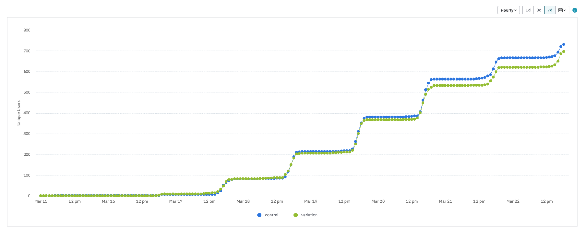

| Mar 15, 2026, 12 AM | 5 | 4 |
| Mar 15, 2026, 1 AM | 5 | 5 |
| Mar 15, 2026, 2 AM | 5 | 5 |
| Mar 15, 2026, 3 AM | 5 | 5 |
| Mar 15, 2026, 4 AM | 5 | 5 |
| Mar 15, 2026, 5 AM | 6 | 6 |
| Mar 15, 2026, 6 AM | 6 | 6 |
| Mar 15, 2026, 7 AM | 6 | 6 |
| Mar 15, 2026, 8 AM | 6 | 6 |
| Mar 15, 2026, 9 AM | 6 | 6 |
| Mar 15, 2026, 10 AM | 8 | 6 |
| Mar 15, 2026, 11 AM | 19 | 6 |
| Mar 15, 2026, 12 PM | 38 | 6 |
| Mar 15, 2026, 1 PM | 58 | 7 |
| Mar 15, 2026, 2 PM | 68 | 18 |
| Mar 15, 2026, 3 PM | 70 | 37 |
| Mar 15, 2026, 4 PM | 70 | 56 |
| Mar 15, 2026, 5 PM | 70 | 65 |
| Mar 15, 2026, 6 PM | 70 | 66 |
| Mar 15, 2026, 7 PM | 70 | 66 |
| Mar 15, 2026, 8 PM | 70 | 66 |
| Mar 15, 2026, 9 PM | 70 | 66 |
| Mar 15, 2026, 10 PM | 70 | 66 |
| Mar 15, 2026, 11 PM | 71 | 66 |
| Mar 16, 2026, 12 AM | 71 | 66 |
| Mar 16, 2026, 1 AM | 71 | 66 |
| Mar 16, 2026, 2 AM | 71 | 66 |
| Mar 16, 2026, 3 AM | 71 | 66 |
| Mar 16, 2026, 4 AM | 71 | 66 |
| Mar 16, 2026, 5 AM | 71 | 66 |
| Mar 16, 2026, 6 AM | 71 | 66 |
| Mar 16, 2026, 7 AM | 71 | 66 |
| Mar 16, 2026, 8 AM | 71 | 66 |
| Mar 16, 2026, 9 AM | 71 | 66 |
| Mar 16, 2026, 10 AM | 75 | 66 |
| Mar 16, 2026, 11 AM | 99 | 66 |
| Mar 16, 2026, 12 PM | 140 | 66 |
| Mar 16, 2026, 1 PM | 190 | 69 |
| Mar 16, 2026, 2 PM | 213 | 94 |
| Mar 16, 2026, 3 PM | 217 | 127 |
| Mar 16, 2026, 4 PM | 217 | 170 |
| Mar 16, 2026, 5 PM | 217 | 191 |
| Mar 16, 2026, 6 PM | 217 | 194 |
| Mar 16, 2026, 7 PM | 217 | 194 |
| Mar 16, 2026, 8 PM | 217 | 194 |
| Mar 16, 2026, 9 PM | 217 | 194 |
| Mar 16, 2026, 10 PM | 217 | 194 |
| Mar 16, 2026, 11 PM | 217 | 194 |
| Mar 17, 2026, 12 AM | 217 | 194 |
| Mar 17, 2026, 1 AM | 217 | 194 |
| Mar 17, 2026, 2 AM | 217 | 194 |
| Mar 17, 2026, 3 AM | 217 | 194 |
| Mar 17, 2026, 4 AM | 217 | 194 |
| Mar 17, 2026, 5 AM | 217 | 194 |
| Mar 17, 2026, 6 AM | 217 | 194 |
| Mar 17, 2026, 7 AM | 217 | 194 |
| Mar 17, 2026, 8 AM | 217 | 194 |
| Mar 17, 2026, 9 AM | 217 | 194 |
| Mar 17, 2026, 10 AM | 221 | 194 |
| Mar 17, 2026, 11 AM | 250 | 194 |
| Mar 17, 2026, 12 PM | 294 | 194 |
| Mar 17, 2026, 1 PM | 354 | 197 |
| Mar 17, 2026, 2 PM | 379 | 225 |
| Mar 17, 2026, 3 PM | 383 | 274 |
| Mar 17, 2026, 4 PM | 383 | 329 |
| Mar 17, 2026, 5 PM | 383 | 352 |
| Mar 17, 2026, 6 PM | 383 | 355 |
| Mar 17, 2026, 7 PM | 383 | 355 |
| Mar 17, 2026, 8 PM | 383 | 355 |
| Mar 17, 2026, 9 PM | 384 | 355 |
| Mar 17, 2026, 10 PM | 384 | 355 |
| Mar 17, 2026, 11 PM | 384 | 355 |
| Mar 18, 2026, 12 AM | 384 | 355 |
| Mar 18, 2026, 1 AM | 384 | 355 |
| Mar 18, 2026, 2 AM | 384 | 355 |
| Mar 18, 2026, 3 AM | 384 | 355 |
| Mar 18, 2026, 4 AM | 385 | 355 |
| Mar 18, 2026, 5 AM | 385 | 355 |
| Mar 18, 2026, 6 AM | 386 | 355 |
| Mar 18, 2026, 7 AM | 386 | 355 |
| Mar 18, 2026, 8 AM | 387 | 355 |
| Mar 18, 2026, 9 AM | 387 | 355 |
| Mar 18, 2026, 10 AM | 392 | 355 |
| Mar 18, 2026, 11 AM | 425 | 356 |
| Mar 18, 2026, 12 PM | 494 | 356 |
| Mar 18, 2026, 1 PM | 549 | 361 |
| Mar 18, 2026, 2 PM | 582 | 390 |
| Mar 18, 2026, 3 PM | 587 | 432 |
| Mar 18, 2026, 4 PM | 587 | 488 |
| Mar 18, 2026, 5 PM | 587 | 519 |
| Mar 18, 2026, 6 PM | 587 | 523 |
| Mar 18, 2026, 7 PM | 587 | 523 |
| Mar 18, 2026, 8 PM | 587 | 523 |
| Mar 18, 2026, 9 PM | 587 | 523 |
| Mar 18, 2026, 10 PM | 587 | 523 |
| Mar 18, 2026, 11 PM | 587 | 523 |
| Mar 19, 2026, 12 AM | 587 | 523 |
| Mar 19, 2026, 1 AM | 587 | 523 |
| Mar 19, 2026, 2 AM | 587 | 523 |
| Mar 19, 2026, 3 AM | 587 | 523 |
| Mar 19, 2026, 4 AM | 587 | 523 |
| Mar 19, 2026, 5 AM | 587 | 523 |
| Mar 19, 2026, 6 AM | 587 | 523 |
| Mar 19, 2026, 7 AM | 587 | 523 |
| Mar 19, 2026, 8 AM | 587 | 523 |
| Mar 19, 2026, 9 AM | 587 | 523 |
| Mar 19, 2026, 10 AM | 589 | 523 |
| Mar 19, 2026, 11 AM | 605 | 523 |
| Mar 19, 2026, 12 PM | 635 | 523 |
| Mar 19, 2026, 1 PM | 670 | 525 |
| Mar 19, 2026, 2 PM | 688 | 541 |
| Mar 19, 2026, 3 PM | 690 | 571 |
| Mar 19, 2026, 4 PM | 690 | 597 |
| Mar 19, 2026, 5 PM | 690 | 614 |
| Mar 19, 2026, 6 PM | 690 | 616 |
| Mar 19, 2026, 7 PM | 690 | 616 |
| Mar 19, 2026, 8 PM | 690 | 616 |
| Mar 19, 2026, 9 PM | 690 | 616 |
| Mar 19, 2026, 10 PM | 690 | 616 |
| Mar 19, 2026, 11 PM | 690 | 616 |
| Mar 20, 2026, 12 AM | 691 | 616 |
This is a more extreme example. The exposures look like a step function. In this case, users who already received the experiment at least once may be evaluating the feature flag again during these flat time periods.
Decreasing slope
An experiment's cumulative exposures can start strong, then slow over time.
| Date | Variant A | Variant B |
| Feb 18, 2026 | 11 | 9 |
| Feb 19, 2026 | 20 | 18 |
| Feb 20, 2026 | 355 | 293 |
| Feb 21, 2026 | 621 | 525 |
| Feb 22, 2026 | 861 | 774 |
| Feb 23, 2026 | 1,085 | 968 |
| Feb 24, 2026 | 1,300 | 1,178 |
| Feb 25, 2026 | 1,522 | 1,413 |
| Feb 26, 2026 | 1,667 | 1,636 |
| Feb 27, 2026 | 1,870 | 1,821 |
| Feb 28, 2026 | 2,027 | 1,979 |
| Mar 1, 2026 | 2,166 | 2,114 |
| Mar 2, 2026 | 2,286 | 2,222 |
| Mar 3, 2026 | 2,426 | 2,345 |
| Mar 4, 2026 | 2,541 | 2,453 |
| Mar 5, 2026 | 2,658 | 2,549 |
| Mar 6, 2026 | 2,759 | 2,659 |
| Mar 7, 2026 | 2,854 | 2,759 |
| Mar 8, 2026 | 2,923 | 2,832 |
| Mar 9, 2026 | 3,001 | 2,907 |
| Mar 10, 2026 | 3,090 | 2,996 |
| Mar 11, 2026 | 3,170 | 3,076 |
| Mar 12, 2026 | 3,224 | 3,131 |
| Mar 13, 2026 | 3,291 | 3,202 |
| Mar 14, 2026 | 3,346 | 3,270 |
| Mar 15, 2026 | 3,396 | 3,312 |
| Mar 16, 2026 | 3,440 | 3,356 |
| Mar 17, 2026 | 3,487 | 3,404 |
| Mar 18, 2026 | 3,516 | 3,448 |
When this experiment launched, about 280 new users received each variant each day. By the end, exposure rates dropped to about 40 new users per variant, per day.
