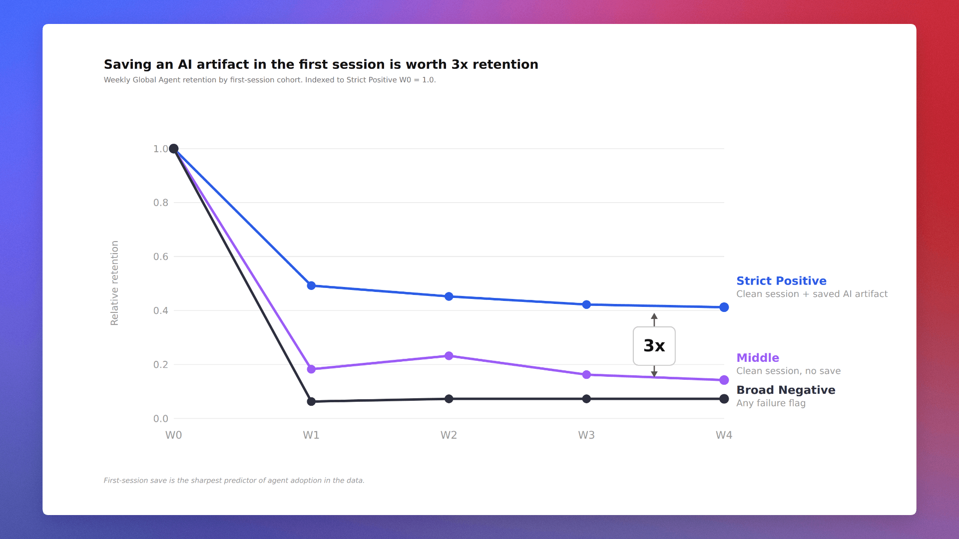

We then layered in the strictest “user got real value” signal in the data: whether they saved the agent’s output (a chart, cohort, dashboard, etc.) and committed it to their workspace.
Chart 3: Users who saved an AI artifact in their first (positive) session retain at 3x the rate of users whose first session hit any failure flag.
That’s a 3.57x gradient at Week 1, holding at 3x by Week 4. Monotonic, persistent, and specific to Global Agent.
If you’re working on an agentic product, measure first-session eval scores and value extraction. Tie it to user engagement and retention so you can show the value of new AI features to your overall business.

Cohort definition: Strict Positive: clean win + extracted value.
- ≥1 session in W with all failure flags = false
- 0 sessions in W with Has Negative Feedback = true
- 0 sessions in W with Has Task Failure = true
- ≥1 product save event (or equivalent value action) with source = <your agent attribution>
Cohort definition: Broad Negative: every session had something wrong.
- ≥1 session in W
- 0 sessions in W with all failure flags = false
Cohort definition: Middle: clean experience, no value extracted.
- 0 product save events with source = <your agent attribution>
