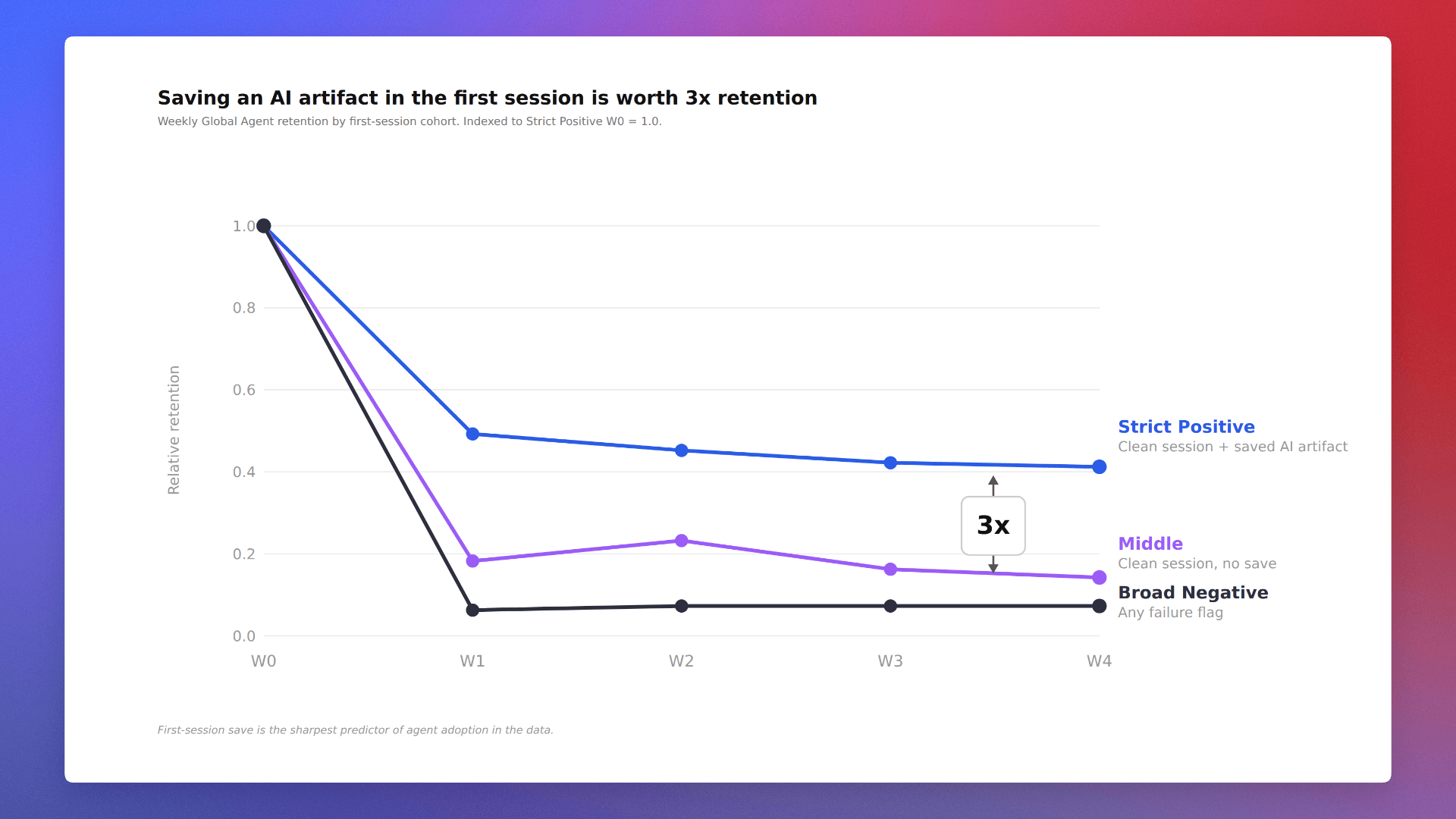

We then layered in the strictest “user got real value” signal in the data: whether they saved the agent’s output (a chart, cohort, dashboard, etc.) and committed it to their workspace.
Chart 3: Users who saved an AI artifact in their first (positive) session retain at 3x the rate of users whose first session hit any failure flag.
Saving an AI artifact in the first session is worth 3x retention
Weekly Global Agent retention by first-session cohort. Indexed to Strict Positive W0 = 1.0.
1.0 0.8 0.6 0.4 0.2 0.0 Relative retention W0 W1 W2 W3 W4 Strict Positive Clean session + saved AI artifact Middle Clean session, no save Broad Negative Any failure flag Strict Positive · 1.00 Strict Positive · 0.48 Strict Positive · 0.44 Strict Positive · 0.41 Strict Positive · 0.40 Middle · 0.17 Middle · 0.22 Middle · 0.15 Middle · 0.13 Broad Negative · 0.05 Broad Negative · 0.06 Broad Negative · 0.06 Broad Negative · 0.06 3x
First-session save is the sharpest predictor of agent adoption in the data.
That’s a 3.57x gradient at Week 1, holding at 3x by Week 4. Monotonic, persistent, and specific to Global Agent.
