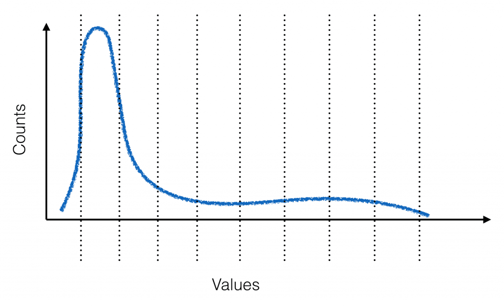

Say you have a highly skewed distribution of values with a long tail:
With evenly spaced buckets (dotted lines – in this example, 10 buckets), you lose resolution exactly where the majority of your values are.

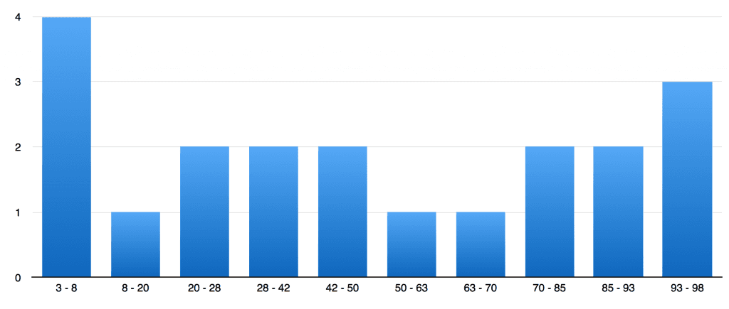

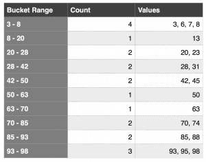

Let’s illustrate with a simple example. We have this list of 20 numbers, and we want to put them in 10 buckets:
3, 6, 7, 8, 13, 20, 23, 28, 31, 42, 45, 50, 63, 70, 74, 85, 88 93, 95, 98
We run the merging algorithm and end up with these bins:
The buckets are all of varying width, which makes the x-axis deceptive. And again, this technique runs into the problem of having to update the bucketing scheme whenever the data’s distribution changes.

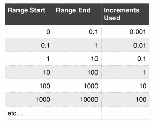

For a given range of values, we used a pre-determined bucket size: 10% increments for every order of magnitude. The table below shows our bucket sizes for a given range of values:

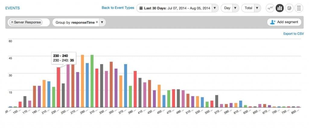

Here’s an example from the Amplitude dashboard. We’re looking at the responseTime property of an event called Server Response. Since the data falls in the 100-1000 range, the buckets are in increments of 10:
