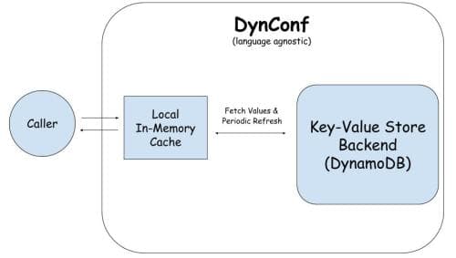

At its core, DynConf is a wrapper around a DynamoDB table call that supports getting string key-value pairs. The wrapper simply adds a layer of local caching with a periodic refresh on any fetched keys, and also provides some type casting and defaulting of the fetched string values.
Besides the fantastic wordplay opportunity, there were several reasons for implementing DynConf this way:
  1. Reliability: Because it’s just a wrapper, DynConf inherits all the robustness of the DynamoDB for free.
  2. Code Simplicity: There was existing code to communicate with DynamoDB, making DynConf very simple to write, use, and think about.
  3. __ Operational Simplicity:__ We didn’t have to worry about being able to scale or manage any clusters of hosts.
  4. Flexibility: With creativity, a generic key-value store can be adapted for almost every dynamic configuration use case (albeit, not optimally).
