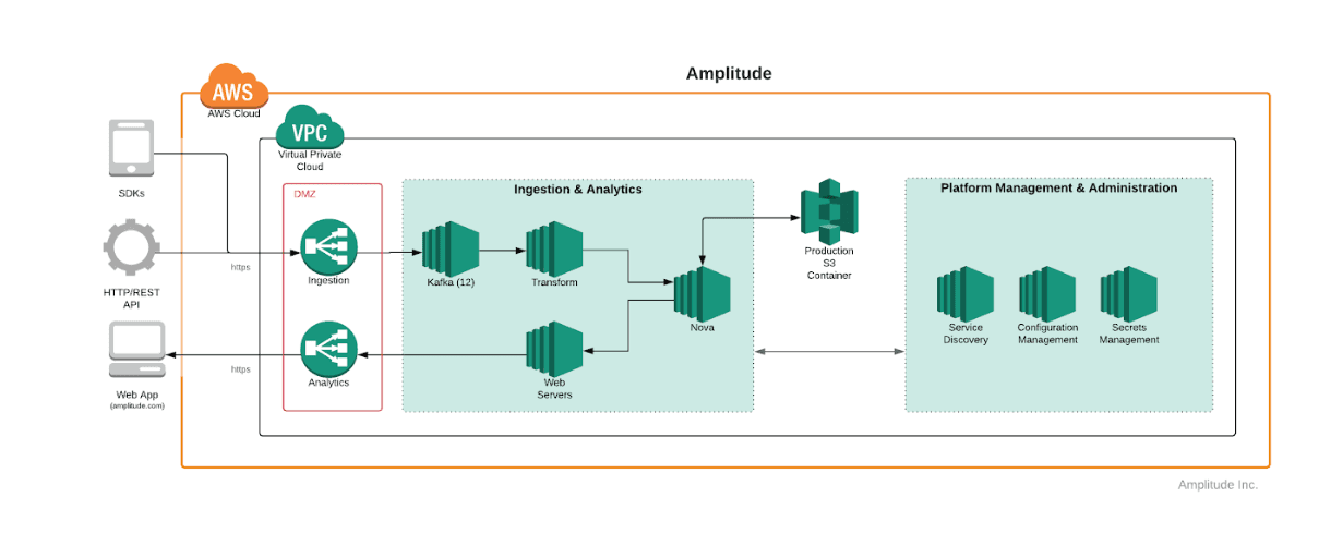

The problem is, if you run 1,400 separate EC2 instances and 50+ services like Amplitude does—many of which have either strict uptime requirements or the potential for data corruption—migrating to VPC can be quite the experience.
It took us over a year to complete the full end-to-end migration, involving 30,000 lines of code in our devops repo alone, but we did it and also managed to build in various other upgrades to boot. Here are 4 of our most significant learnings that we picked up along the way.

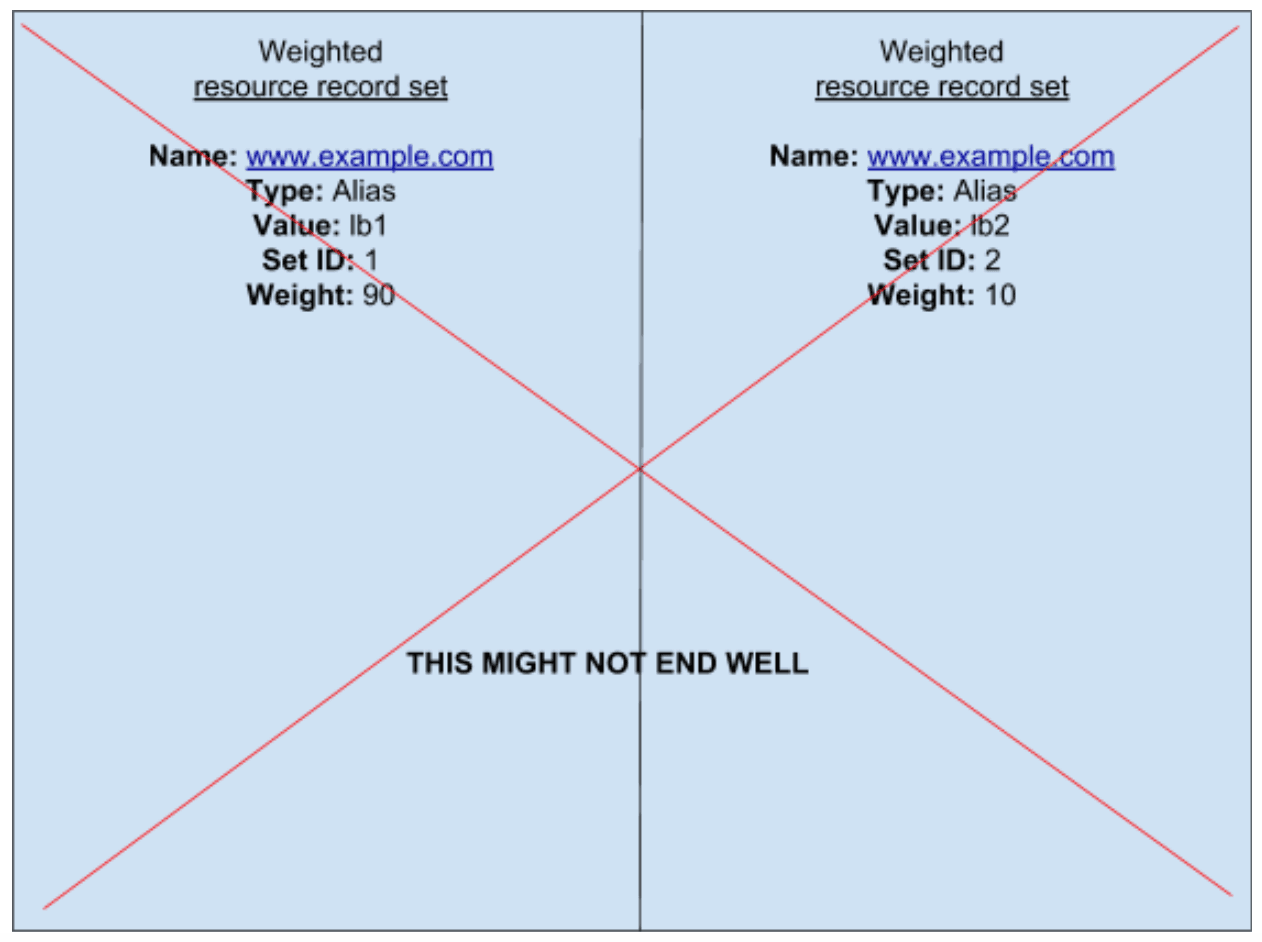

1. Don’t use a weighted DNS round-robin to progressively roll out a new version of a customer-facing service
When you’re rolling out a new version of a customer facing service in AWS, there’s a bit of faux DNS magic that is tempting to use but ultimately dangerous: the weighted round robin.
Here’s how it works: each of the resource sets that a DNS record points to receives traffic based on a weight factor you specify. That means that if you’re rolling out a new service, changing those weight factors based on cluster can seem like a magically convenient way of doing things—you can send just 10% of your traffic to a new spritely test cluster, keeping the remaining 90% going to your curmudgeonly battle-hardened veteran cluster, for example.
It can also appear great when the spritely test cluster decides it hates you and your 500 rate shoots up by 10x. When that happens, you can simply set the weight to 0% on the test cluster, and after a brief TTL period, traffic seems to magically stop flowing to it.
But, even if you have an appropriate TTL on your DNS record, there are actually ISPs that will completely ignore your TTLs (and even in some cases individual customers who have their own overly aggressive caching). In the worst case scenario, 100% of your customers might happen to use an ISP that ignores your TTL, resulting in 100% of your customers continuing to hit the test cluster with some percentage of their requests for some amount of time that is completely outside your control.
This pitfall may actually be fine for some folks – it all depends on the context. However, given that there are easier and more reliable alternatives available, I’d suggest just generally avoiding weighted round robin as a progressive rollout mechanism.
Engineering tip:
There are certainly less finicky ways of progressively rolling out a test cluster that will give you a lot more control. One of the simplest options in AWS is to use two Auto Scaling groups, assuming you’re dealing with a service that is appropriate for Auto Scaling. All you have to do is manage the scaling of the two groups independently. For example, you can arrange the first cluster to be fixed at 10 nodes, while the second cluster scales between 50 and 100 nodes. Then, once you’re more comfortable with the new cluster, you can tweak the scaling.
Whatever option you choose, ideally it will allow you to control the traffic flow as reliably as possible, otherwise you may find yourself in a nightmare situation when you discover that you’re dealing with an ISP whose company slogan is “we might connect you to something, but only if we feel like it.”

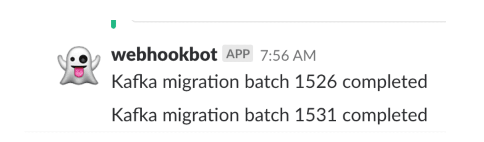

In our case, we first tried out the i3 instances on one of our Kafka clusters, which promised better performance for less money than our previous setup due to the fact that we had been using large EBS attachments instead of free instance stores. I wrote a custom Kafka migration script to handle moving the huge amounts of data in our system without being too disruptive to anything upstream or downstream, complete with a goofy slackbot that would ping everyone with a deliberately obnoxious emoji whenever there was progress.
Victory was at hand, until Kafka did what it does best and reminded us all that we’re merely foolish mortals and Trix are for kids. In dramatic fashion at 3AM one morning, the majority of the hosts in that Kafka cluster began crashing and spewing scary looking messages into syslog that looked like:
blk_update_request: I/O error, dev nvme0n1, sector 123290040
Everytime a Kafka process crashed, we would go and restart it, only to see it crash again a few minutes later, and always with those menacing nvme errors piling up.
Google seemingly came to the rescue, as we discovered a bug thread related to buffer I/O errors on i3 nvme devices. After scrolling through the thread long enough for my doubts to simmer and thicken into a demi-glace of suck, I eventually found a concrete recommendation that seemed too crazy to be made up, which also required a reboot of all the impacted hosts.
The recommendation turned out to just buy a bit of time at best. The next day, all of the hosts crashed again for the same reason. We brought back the custom Kafka migration script, naturally still with the deliberately obnoxious emoji notifications, and reluctantly moved all the data back to the original cluster so that we could regroup in peace. After a series of AWS support messages, we eventually realized i3 instances are only officially recommended for certain operating systems – and ours was not on the list.
