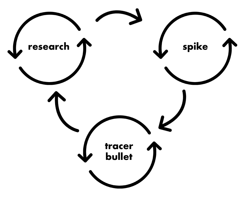

We run these three techniques in cycles depending on what stage of uncertainty we’re at with a particular problem.
This methodology helps us get work done while overcoming the pitfalls of conventional project planning:
- We can move fast: But not so fast that we bury ourselves in technical debt.
- We can make adjustments on the go: Rather than being beholden to a sprint date.
- We can learn iteratively: Rather than relying on the team to know everything about the problem space beforehand.
If we’re very uncertain—we have no idea what to do about a problem—we do research. Once the research we’ve done has revealed a possible solution, we use a spike to learn more about the domain. Lastly, we’ll do a tracer bullet to see whether our solution will work as a long-term piece of our architecture. If that’s successful, we move on. If not, we can go back to Square One on that problem.

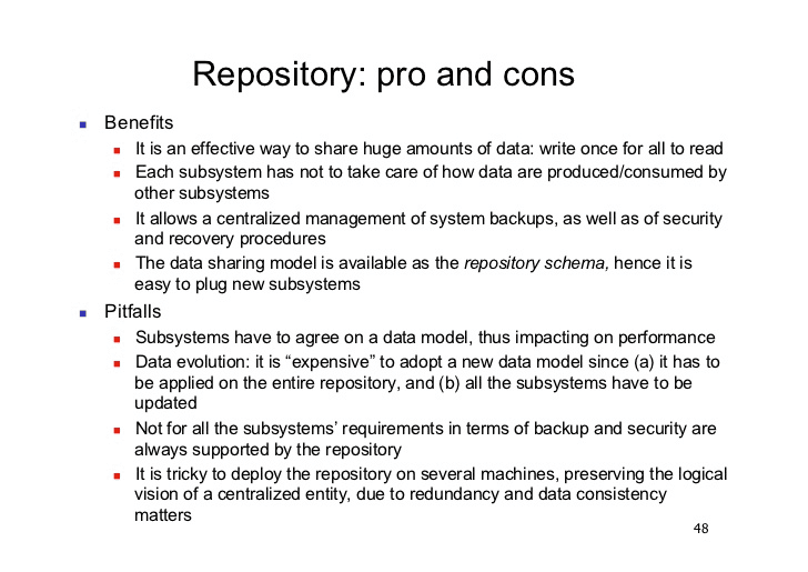

When you have no idea how to fix your problem, you shouldn’t even bother coding. Instead, you should do your research—develop a list of different options, and then create pros and cons for each one.
These pros and cons should be based on technical factors like:
- How difficult the implementation would be
- How expensive it would be
- How much time it would take
- What future design decisions are locked in by this choice
- How easy to use the result will be
The factors you weigh the most will likely be unique to your team. At RankScience, right now, the three main factors we’re working to optimize for are:
- Our operational burden
- Our bus count
- Our team velocity
We’re entering the research phase of every uncertain decision thinking about how we can reduce our operational burden, increase our bus count, and improve our team velocity.
One common outcome of research is documentation—in this case, a slide deck.[/caption]
Research should be time-boxed as an activity (so that you don’t spend an endless amount of time reviewing different options) and it should also have a concrete output that will mark the end of the research phase. That will usually, but not always, be a decision about which possible solution to pursue. It’s also possible that your research cycle will reveal that you shouldn’t try to solve the problem you were studying at all, or that you would be better off hiring someone from the outside to look at it.

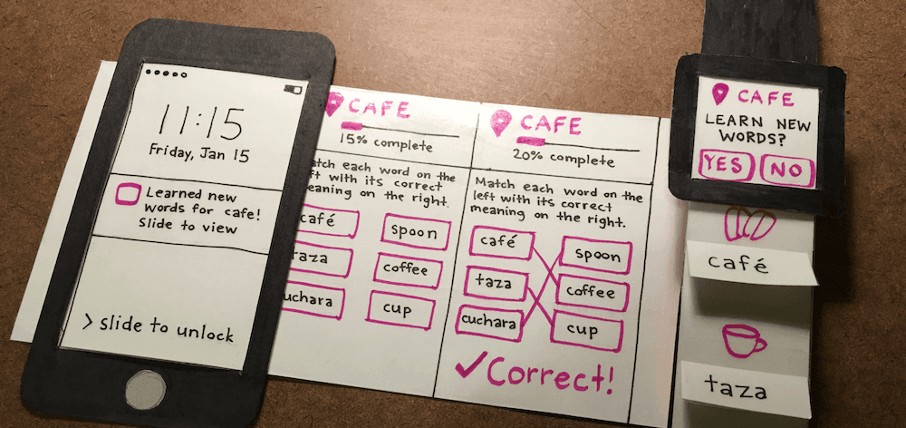

The spike is a scrappy, throwaway solution to a problem. It sometimes gets flak as a waste of time, but a good spike can teach you things about your problem that you could never learn by jumping straight into building.
A spike is work you throw away when you’re done—but used correctly, it can help you learn a lot about the problem you’re trying to solve.
The spike itself is not going to help you build your final product any faster, but the lessons you acquire from watching people and reality interact with it will.
A good example is the paper prototype.
Mocking up a paper prototype of your idea, for example, might seem pointless in an age where you can rapidly create mockups in Sketch and export them to any format you want—but human user testers can work and play with paper. They can get a tactile sense of your product. They can make suggestions much more easily.
In conventional project planning, your minimum viable solution to a problem is how you begin actually solving that problem. In a spike, your minimum viable solution to a problem is what helps you understand what that problem really is.

The research-spike-tracer bullet cycle
When you’re working with uncertainty in the product development process, you need to adjust how you think about “moving fast.”
Moving fast no longer becomes about getting a completed plan together as quickly as possible, because there is no realistic expectation that a complete plan is even possible.
When you’re working with products with extreme uncertainty or technical risks, you should use research, spikes, and tracer bullets to cut iteratively through that uncertainty—and get little glimmers of answers along the way.
