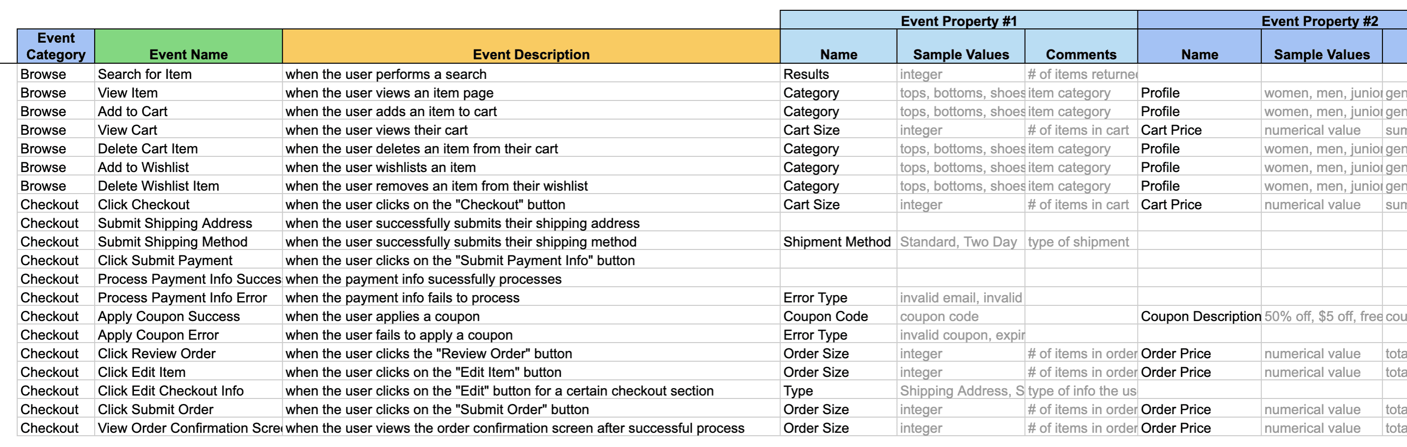

Structure, which can be as simple as a taxonomy spreadsheet, goes a long way when instrumenting.
