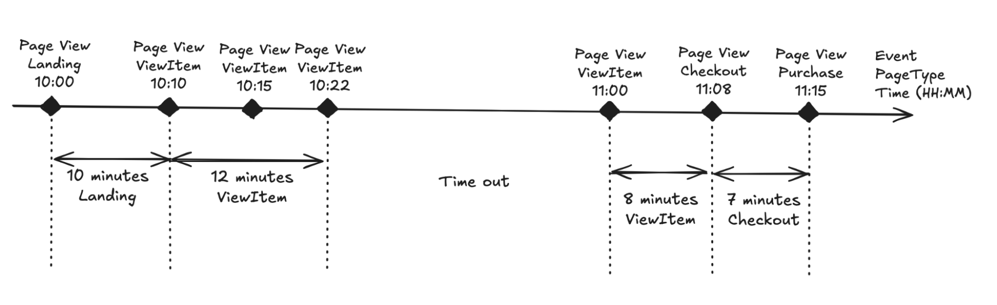

Amplitude calculates the time spent on an event as the duration between consecutive events of the specified type. To prevent long periods of inactivity from skewing the analysis, Amplitude applies a 30-minute timeout. If no events of the specified type occur within a 30-minute window, Amplitude closes the current time spent window and begins a new window with the next event.
When you specify a group-by property, such as page URL or page type, any change in its value resets the time spent window. This ensures that Amplitude can attribute time spent to the specific value of the group-by property at the beginning of each window.
In the following example, the timeline represents a set of consecutive page views and their associated page types.
| Page type | Time spent |
Landing | 10 minutes |
ViewItem | 20 minutes |
Checkout | 7 minutes |

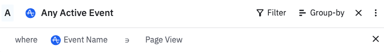

Primitive page view event: A basic event designed to track page views. For example, the predefined
[Amplitude] Page Viewevent.Any active event where Event Name ∈ 'Page View': Some taxonomies define page view at the property level. Use a filter to limit event selection to names that contain
page view.Custom page view event: A combination of primitive events that collectively represent a page view.
