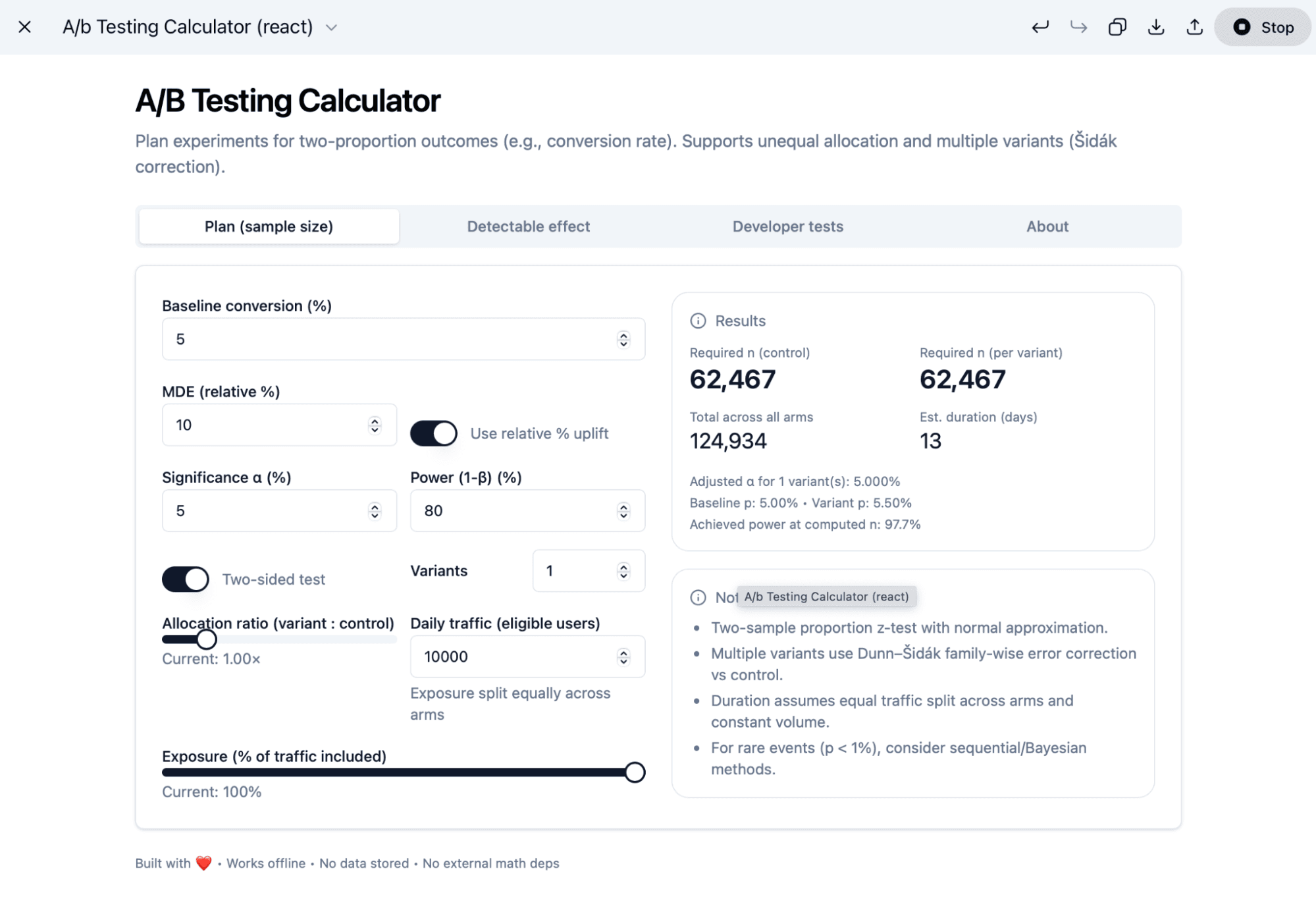

Search the web for A/B testing calculators, and you'll find a slew of free tools that all do the same thing—calculate sample size. They all look roughly like this:
  • Inputs for conversion rate, minimum detectable effect (MDE), and statistical significance level
  • Output is amount of sample needed per variation
In fact, the focus on sample size is so common that you can even ask ChatGPT to build an A/B testing calculator for you, and it’ll come up with the same formula. Here’s an A/B testing calculator I built in one shot with ChatGPT 5:
And because these calculators are so widespread, it’s easy to ignore a simple truth about them: they’re fundamentally misaligned with how experimenters should be working. They fail to prioritize constraints, and they don’t focus on the actual job to be done for the person running the test. So why do we keep using them?
I believe the industry is overlooking what product managers and experimenters truly need: not a sample size calculator with a single answer, but an MDE calculator with a range of results over time.
