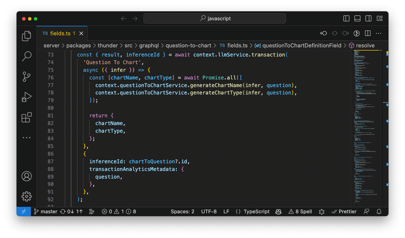

Our first attempt at building Ask Amplitude involved providing some example charts and events in the prompt as in-context learning. Then we directly asked for a chart definition that answers the user’s question.
This was promising at first, but quickly became impractical. We found that the LLM would hallucinate configuration keys and values and often generate invalid JSON. It would also misinterpret the question. The complexity of what we were asking it to do was too high, leaving ample room for error.
This is where we realized we could make use of a classic software engineering principle—KISS (keep it simple, stupid). LLMs, like humans, do better when given clear and specific tasks. So we broke down the process of creating a chart into the individual decisions a human needs to make, such as:
  • What type of chart? (e.g. conversion funnel, segmentation, retention)
  • Which events should be included?
  • What time range should be analyzed?
  • What filters should be applied?
  • What “group bys” should be applied?
We then stitched together each of the individual answers in code to consistently get a valid JSON query definition. Simplifying the individual LLM tasks reduced hallucinations, made the results more consistent, enabled better recall, and enabled us to parallelize prompts—making generation much faster.

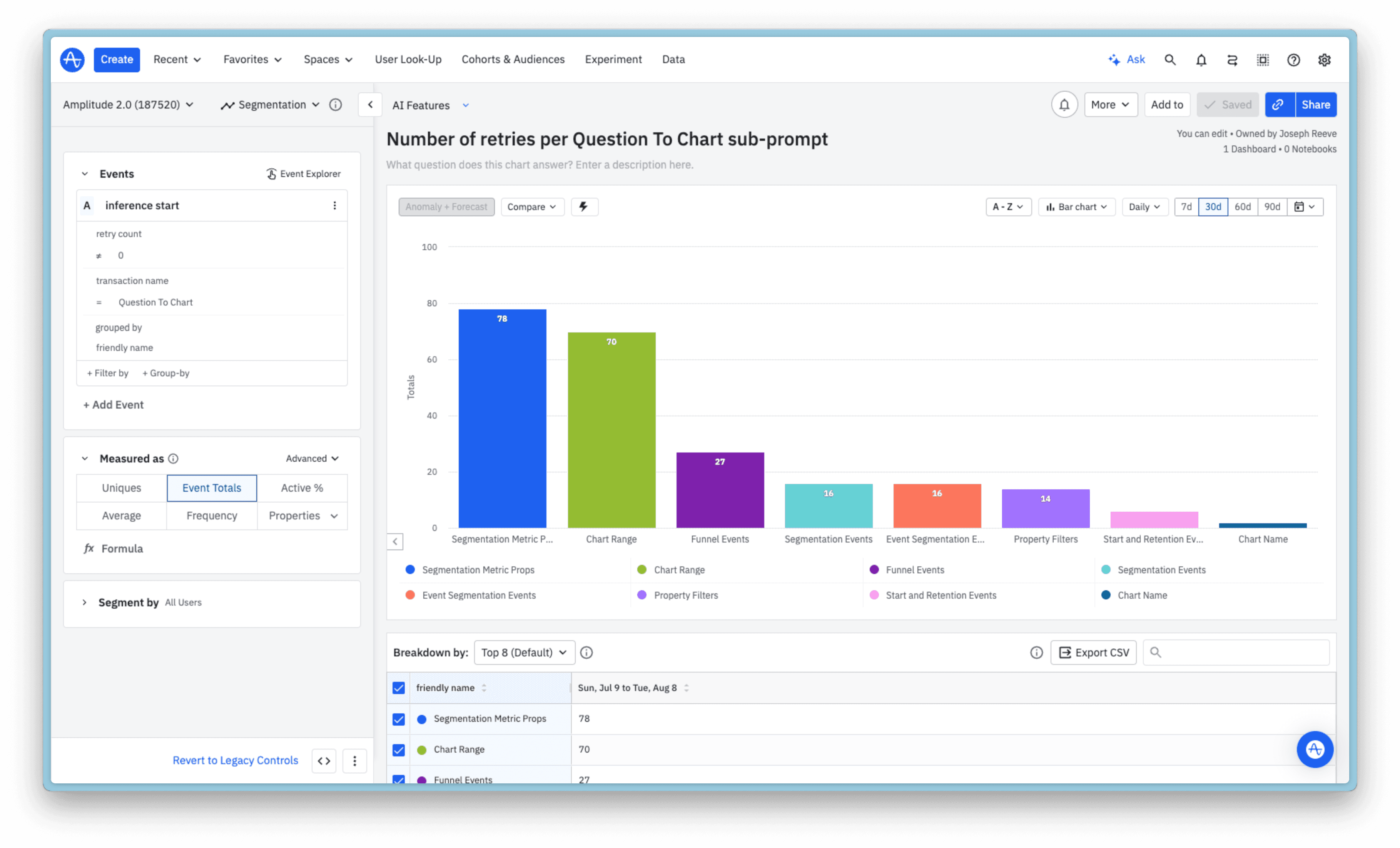

An important job of LLMs in Ask Amplitude is selecting values from a list. Some percent of the time, the models hallucinate invalid values or response formats, so we needed a way to validate and retry on invalid responses. Our inference wrapper supports validating data types, enums, and even JSON. If validation fails, the wrapper will retry up to the specified number of times before throwing an error.
The wrapper logs all sorts of data about inferences into Amplitude, so we can track trends and prioritize our prompt engineering efforts.
Validation to help with the prioritization of prompt engineering efforts
