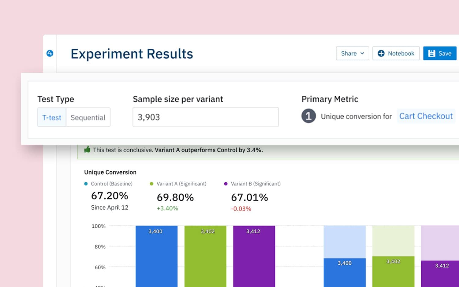

Image showing a sequential and t-test toggle in Amplitude Experiment

At Amplitude, we have recently released a fixed horizon T-test in addition to sequential testing, which we have had since the beginning of Experiment. We envision several customers asking “How do I know what test to pick?”
