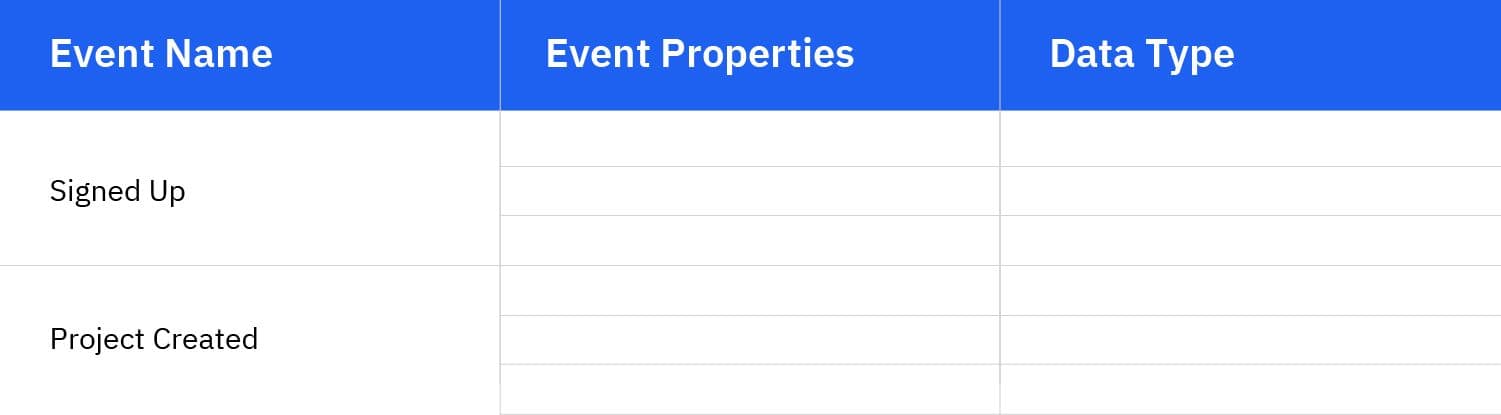

List down the events
Under Events and Event Properties, list down the core events you need to track to answer the burning questions.
The sheet contains sample events Signed Up and Project Created, and their respective properties. For now, ignore the properties and just focus on the events.
These two events, for example, can answer the question “what percentage of new users created a project” and since every event carries a timestamp, you can drill down to fetch data only from a specific period such as the last 7 days.
In the above example, Project Created is the activation event, and to get to the point where one can perform the activation event, one has to first sign up (perform the Signed Up event).

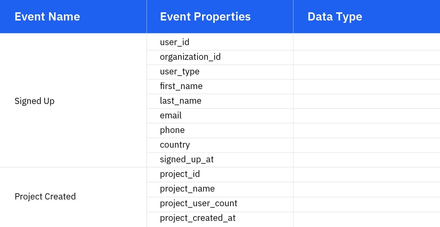

Add the properties for every event
Tackle one event at a time and think about the properties that give you more context about the event.
It helps to keep in mind that a user performs the Signed Up event only once (at the time of creating an account) and this is when the unique identifier user_id is generated.
If group properties are applicable to your product, the group identifier organization_id is also generated when a user signs up for a new account. In case a user is invited to join an existing organization, a new organization_id is not generated for that user.
Besides the system-generated identifiers, Signed Up carries a property for every piece of information that is gathered from the user when that event takes place (first_name, last_name, email, etc).
The property user_type helps differentiate those who signed up organically from the ones who were invited to join an existing account (Invited) or referred by someone to create their own account (Referred).
Interesting note: The event properties associated with Signed Up tell you more about the user (PII and traits); therefore, these properties also act as user properties and are added under the User Properties sheet.
Other events like Project Created can be performed multiple times and the properties associated with the event should only be restricted to those that provide context about one occurrence of that event.
Besides the project ID (project_id) and the timestamp (project_created_at), the properties project_name and project_user_count provide additional info every time a project is created (the event Project Created is performed).
Additionally, the user_id needs to be associated with every event to know who performed the event. If your product needs to track account-level activity, a group identifier such as organization_id also needs to be associated with every event.

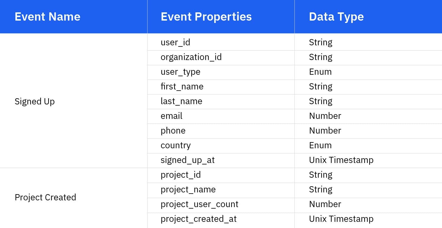

Specify the data types and expected values
The importance of specifying the data type for every property was briefly covered in this guide. Doing so helps greatly in the instrumentation process and is a critical step toward maintaining data consistency.
Specifying the expected values for properties is also very helpful for those tasked with the implementation and also enables everybody to be on the same page when a property is supposed to contain predefined values.
Properties with data type enum or array should always specify the expected values—either the precise values (as done for user_type) or a reference to a specific list of values (as done for country).

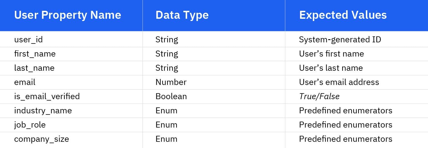

User properties
As you might already know, user properties store various details and traits about users, enabling you to identify them and segment them based on those properties.
Also, as mentioned above, the data gathered from users at the time of signing up are added as user properties as these properties are essentially user attributes that contain a user’s traits and reflect their current state.
Some of these properties remain fixed while others are subject to change. If a user changes their name on file or the registered email address, the respective properties are updated with the new values.
Please note that the value of the property is_email_verified changes to false when the email is changed and once the new email is verified, is_email_verified changes back to true.
Other information gathered from users via surveys, such as the industry they belong to or their job role, is also stored as user properties—they help create user segments for analysis and activation purposes.
Go ahead and list down all user properties, their data types, expected values, and destinations in the sheet labeled User Properties.

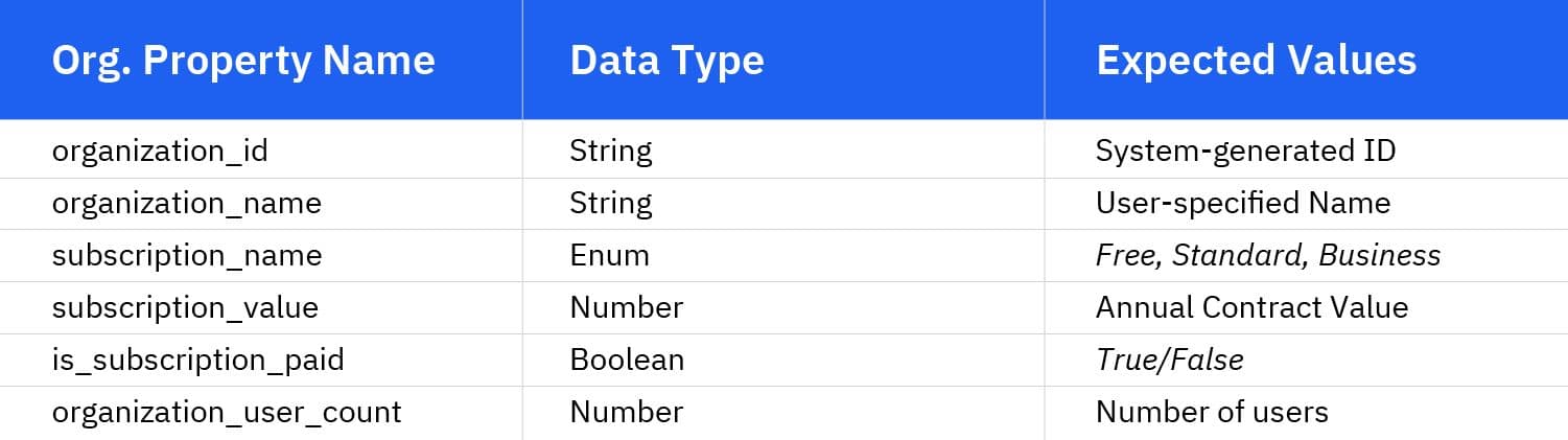

Organization properties
Organization properties or group properties only apply to products that need to track user activity at an account level.
Like user properties, organization properties store details about organizations or accounts. Any piece of data that is not associated with a particular user and provides context about the account the user belongs to is stored as an organization property.
As you might already know, group properties are common for B2B SaaS products where a user is part of an account or organization with multiple users. The account name (organization_name) and its subscription plan (subscription_plan_name) are common group properties applicable to most businesses.
However, depending on your product, there could be many more properties associated with the account or organization and not a user. You must think this through and maybe even involve your engineering team when deciding whether a property should be a user property or an organization property.
Once you know for sure, go ahead and list down all organization properties, their data types, expected values, and destinations in the sheet labeled Organization (Group) Properties.
