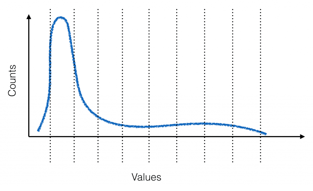

Say you have a highly skewed distribution of values with a long tail:
skewed histogram image
With evenly spaced buckets (dotted lines – in this example, 10 buckets), you lose resolution exactly where the majority of your values are.

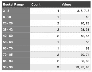

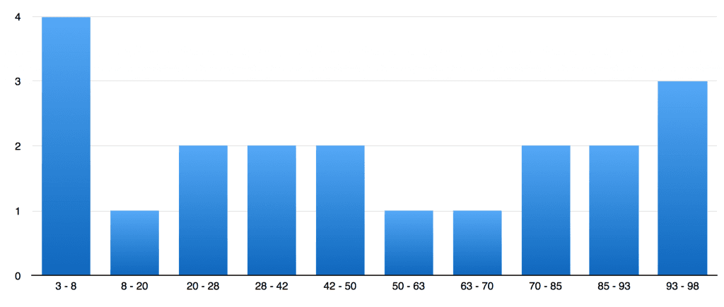

Let’s illustrate with a simple example. We have this list of 20 numbers, and we want to put them in 10 buckets:
3, 6, 7, 8, 13, 20, 23, 28, 31, 42, 45, 50, 63, 70, 74, 85, 88 93, 95, 98
We run the merging algorithm and end up with these bins:
bucket-tech-2-table
bucketing-tech-2-histo
The buckets are all of varying width, which makes the x-axis deceptive. And again, this technique runs into the problem of having to update the bucketing scheme whenever the data’s distribution changes.

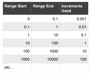

Technique #4: Pre-create buckets on a logarithmic scale
For a given range of values, we used a pre-determined bucket size: 10% increments for every order of magnitude. The table below shows our bucket sizes for a given range of values:
bucketing-tech-4-table

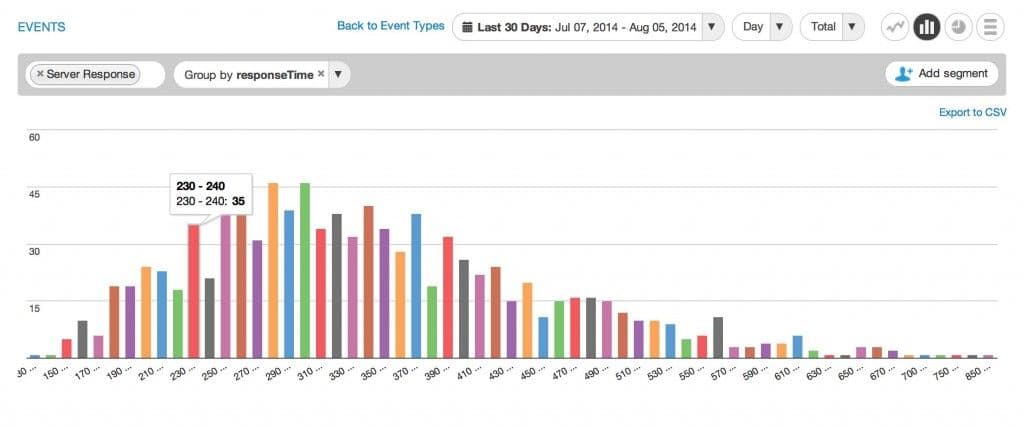

Here’s an example from the Amplitude dashboard. We’re looking at the responseTime property of an event called Server Response. Since the data falls in the 100-1000 range, the buckets are in increments of 10:
bucketing-screenshot2

1. Resolution: This method ensures that no matter what a value is, the range of the bucket will be within 10% of the true value, or two significant figures. That’s plenty for almost all histograming needs.
2. Fixed width buckets: With this method, having buckets of fixed width is a viable option. We no longer have to worry about adjusting the buckets every time the distribution changes. This bucketing scheme should work for a variety of data set types, and works across any range of values.
3. Strange spacing: With these pre-determined buckets that can be applied to any range of values, we no longer have weird buckets like 63.47 to 84.19. Everything is nice and neat.
Admittedly, this method is still not ideal for data visualization if your data spans several orders of magnitude. Buckets have different widths at different orders of magnitude, but at least the width progresses in a way that’s predictable and is fixable in a visualization.
