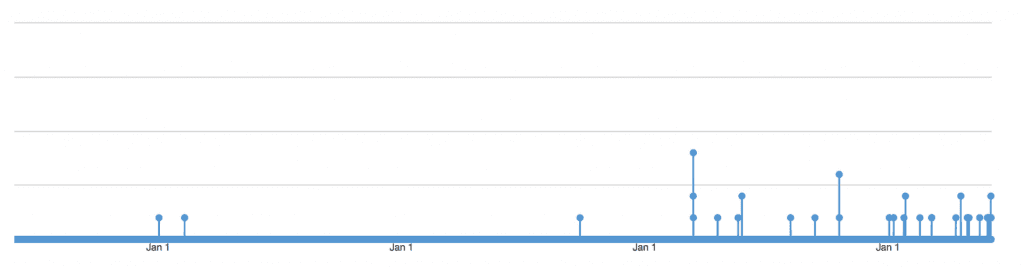

What happens if the phone’s clock is incorrect?
For example, here’s the number of events per day of a mobile app that first included analytics instrumentation on April 25th: There are a non-zero number of events being logged in the days leading up to April 24th. In other words, according to this graph, data has been logged by the phone before instrumentation was put in place. Going back further in time for the same app, here’s a graph logging events from January 1970 up to 1 month before instrumentation: From the examples above, it’s clear that some people’s clocks are significantly off, in some cases by years. It’s not possible that clients were logging data before they instrumented Amplitude! So how do we get around this problem? We could timestamp all events to the time when our servers receive the event (the server upload time), but this would be inaccurate as well — around 5% of data is uploaded at least 24 hours after the event actually happened.

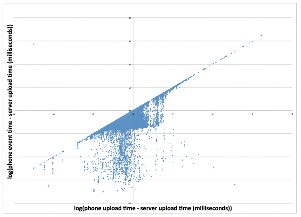

What if we tracked the phone’s timestamp when it uploaded the data?
For each event, let’s compare the difference between the phone event timestamp and the server upload time versus the difference between the phone upload timestamp and the server upload time: Difficult to read! Let’s put both axes on a log scale: There are virtually no data points above the y=x line. This makes sense, since the time the event is logged on the phone shouldn’t be later than the time the event is uploaded to our servers. This suggests a very straightforward solution to our timestamp problem: for each event timestamp, subtract the difference between the phone’s upload time and the server’s upload time, and then adjust the phone’s event timestamp accordingly. This should account for how much the phone’s clock was off when the event was first saved. So there you have it — our simple solution for keeping track of when your events happened. Hope this helps you get more accurate timestamp data from all those phones!
